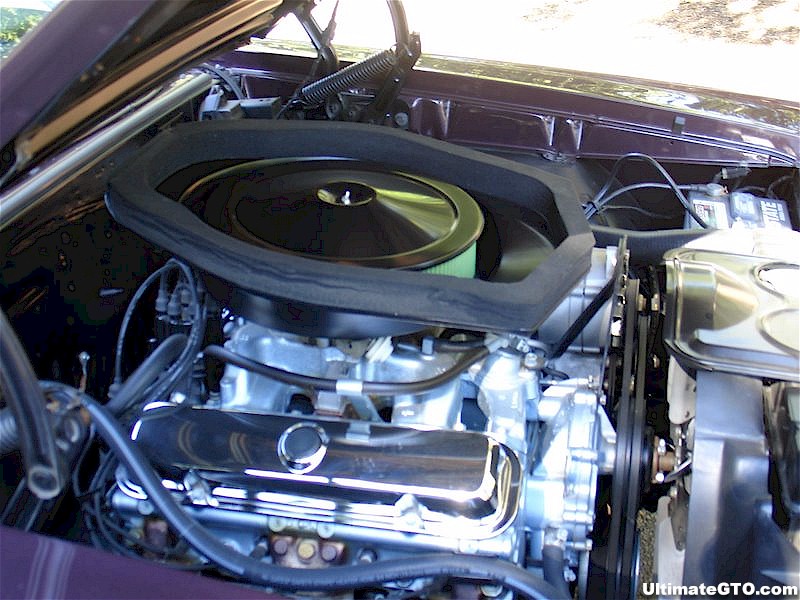

My 67 has a 69 400 and the PVC vent is exacly where Old Indian states. In 68/69 Pontiac improved the 400 design adding a larger 11 bolt water pump and relocating the PVC valve to the front. Attached is a picture of the 69 400 in my 67;

I suppose where the hole is located on the valley pan will dictate were the PVC will be. In any case we all agree it should be on the passenger side.
^^Freakin sweet looking engine bays!!!!
