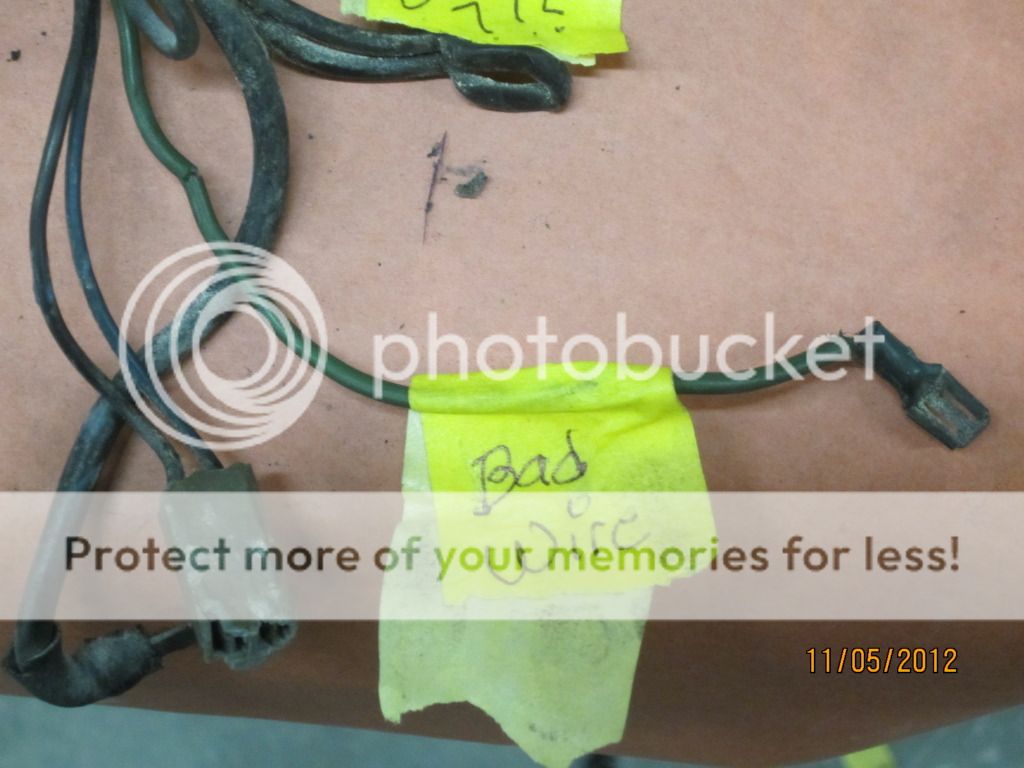

Took a better look at the dash harness. Not as bad as we first thought. we are able to repair and cleanup easily enough.
Now we are into the engine and forward harnesses.
Got a few questions to ask.
This is the engine harness, the green wire plastic is brittle, cracked just trying to straighten also connection broke off. Can anyone tell us what it is for, also black plug connection either melted or has been drug on the pavement, what's it for.
We didn't pull the engine and tranny ourselves so we are kinda in the dark.
Bill

Man, that thing is roached, I would definitely replace that engine harness. You don't want a fire (my harness caused a fire in mine once). If you look at the sticky above this section, there is one for wire diagrams, post #13 is for 68's. The M&H harness comes with all the correct connectors, uses the correct colors and is even wrapped to match the original harness exactly. Those wires look like they go to the alternator and the temp. sensor.
68 4 Spd
Can't Thank you enough for the link to M&H
We dug into the engine harness a little further and found a bare hot wire with a bare ground wire next to it
Brent called M&H this afternoon, they had a harness in stock.
We will have it on Friday
Thanks a bunch
Bill
