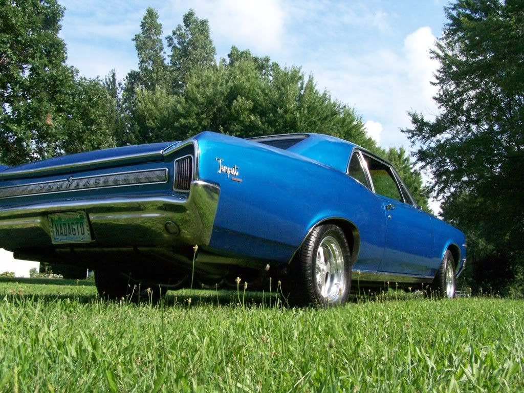

Thanks, drag bags do not raise it much but stiffen it up and help with the body roll as wide tires will rub on the two inch inner wheel well lip if you throw a couple passengers in the back. No problem with the bags, cheap and easy, and unlike air shocks they still let your gas shocks and springs do their job. Be sure to plumb them on separate lines that way you can adjust them independently.
From the factory they tended to be level and look slightly raked to the back. Some guys like to drop the front to get the look but on these big cars with heavy motors, and infamous under steer, that can create some steering geometry and front end travel issues. Plus you have to baby it over every hump and dip so you don't tear your header collectors off. One of the nice things about these cars when the suspension is buttoned up tight is they drive like they were intended, a 400 HP sport sedan that can chew up some blacktop in comfort and style.
In this pic you can see how deep the inner lips is in the rears.

That looks pretty tight. No way I get 275/60/15's in there with a stock set-up. Thanks again for the info.
