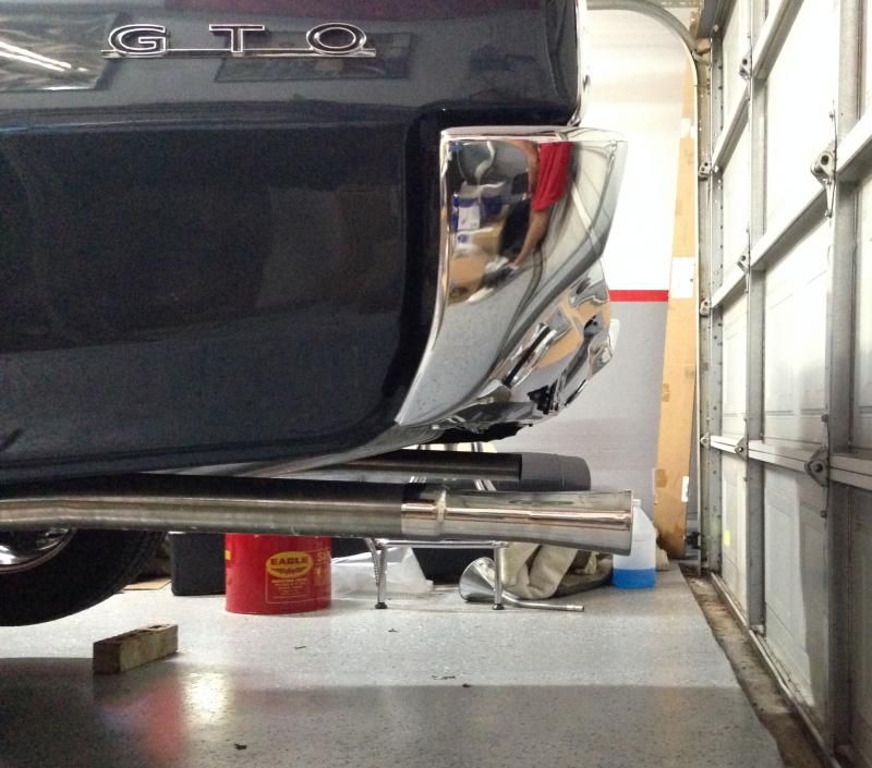

According to Paul Zazarine's GTO Resto Guide, trumpet tip extensions were options on manual cars.
I mocked mine up as you can see in the picture below. I know it's too far out right now, I just want to cut the pipe once.
How far do the tips go past the bottom edge of the bumper?
I would like to avoid tarnishing the bumper with exhaust.

They need to go in about 6 inches, but the pipes need to be bent first. They are much too low. They need to come up about 3-4 inches. And installed correctly, they will allow the chrome to be in harms way. Regular maintenance will help or cure that, though. (polishing and waxing)

The ones that I've seen which were purported to be "correct" were tucked up into the bumper (slight radius'd cutouts exist) and pointed slightly downwards. I attempted to duplicate this on my '67 and they look really good in my opinion.

Chuck's install looks correct to me. I've seen them going straight out, too, but either way, his placement and distance from the bumper is correct.
