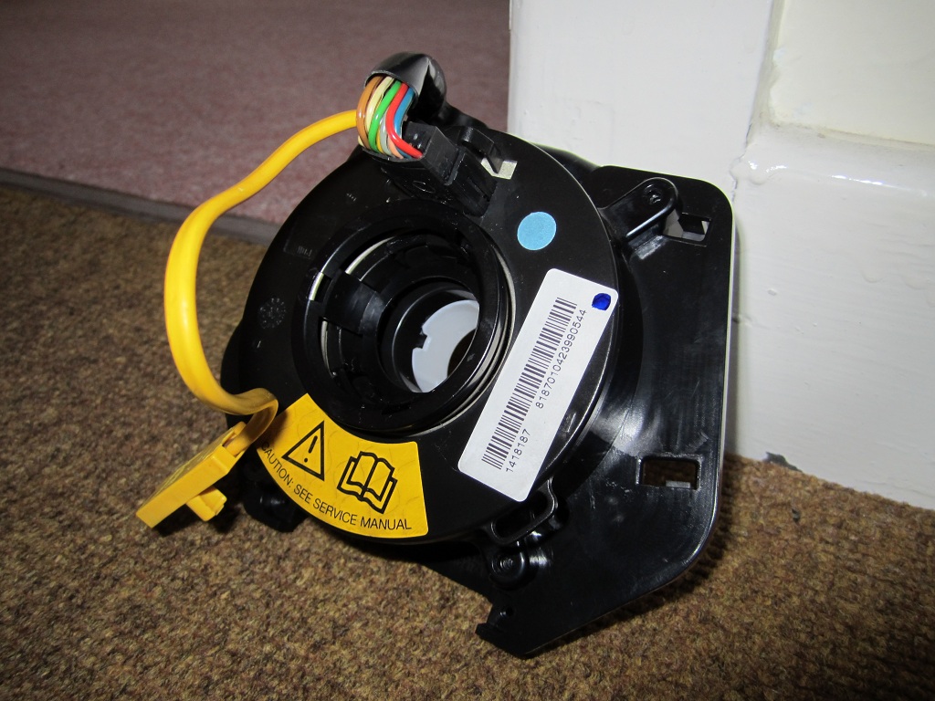

I went to the dealer today for this problem, the (SRS Airbag Fault) animation warning with alarming sound while driving for no apparent reason!
What I've learned about the problem is that
The dealers technician used a (Tech 2) GM Certified scan tool which diagnosed a problem with the ( Clock Spring )!
Member (PEARL JAM) posted some good diagrams for the Clock Spring location, (No. 3)
(Clock Spring)
I'll simplify the installation process as I saw in the dealer's garage:
1- Removed the battery negative connector.
2- Inside the car; he removed the Airbag + the steering wheel. Removed the (above knees) cover + the steering column upper & lower covers.
3- Carefully removed the (Clock Spring) connectors & then the Clock Spring itself.
4- Reverse the process to install the new Clock Spring.
5- Used the (Tech 2) scan tool to reset & clear the fault warning.
By the way; I live in Kuwait & the fix cost me back (125 K.D),
that is about (455.9 $)!
It took about 2 hours to replace the Clock Spring!
Like many of the respected members noted that only a (Tech 2) GM Certified scan tool could diagnose this kind of faults; if you don't have one, go to the dealer & have the fault checked.
Remember my friend; this solution does not apply for all the (SRS Airbag Fault) problems, this is but one solution for one problem!
Note that the Pontiac GTOs Clock Spring is made in France!!
Mercie & Good Luck!!!
