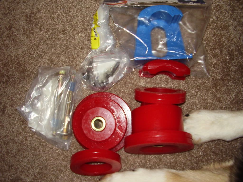

If you go with the Energy Suspension rear subframe kit go with the Lovells rear diff insert to go with it. The diff insert that comes with the Energy Suspension package is a small half moon shape. The Lovells and Pedders diff insert fills all the voids in the rear diff. Don't know if it makes a bigg differance but atlease I feel better about it.
The Energy Suspension insert is below the Lovells diff insert(blue).
