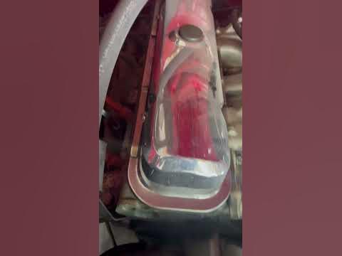

Hello
Car hasnt been running in several years
Drained gas, changed oil and started
Not an expert but does this sound normal or goes this sound like too much lifter noise?
400 Pontiac
Small cam
10w-30 oil
Engine was running for 5 minutes when i took this video
Thank you!
Did you change the filter?
Is the 10W-30 oil non-synthetic oil with the correct amount of ZDDP in it?
Did you pull the plugs and check them? Did you squirt any light oil into the cylinders? Did you crank the engine with the plugs out to build up oil pressure to prime the system before firing it up?
Did you pull the valve covers to check that all the rocker arm nuts were torque down or inspect for loose rocker arms?

It's always hard to diagnose engine noises with a video...so, I will suggest checking your rocker arms (like Jim mentions) in case some of the rocker nuts have backed off, What I am hearing is not lifter "ticking", but more like rocker arm "chatter". The first half of the video sounds pretty normal until the last half...then it sounds like you drug the microphone across the collar of your shirtt...or getting closer to the engine allowed the "noise" to be recorded well. Your 400 should not have rocker noise. At least not over the normal sound levels.

No offense but your video is useless. If it's been sitting for any length of time you will likely get top-end chatter.
You should have primed it first to get those juices flowing before firing it up.
If you let it get up to temp and idle for 20/30 and you still have chatter, Replace the filter this will remove about a Qt of oil, and add Rislone.
I would try this before tearing into it, these old Pontiacs don't like to sit, they need to be Driven.
This usually frees up those sticking lifters nicely. If the chatter persists then you'll need to look under the Valve covers as mentioned.

Hello
400 Pontiac
Small cam
10w-30 oil
Thank you!
