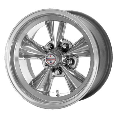

3.) American Racing Vintage
American Racing T71R5761 - American Racing Vintage Series T71R Polished Wheels - Overview - SummitRacing.com
All are 7x15" with difference in offset (0 to +6).
The #1 will need some other wheel lug nuts, because it has a bolt circle of 5x4,5/4,75/5.. can someone tell me which ones I need at summit? I only know my GTO has 5x4,75.
What do you think??

Yeah, +1 on #2, the steel Cragars rust. And they will look Awsome on your car. I like the #3 wheels but they've just been played out, everybody has them it seems, but still a good choice that won't go out of style.
