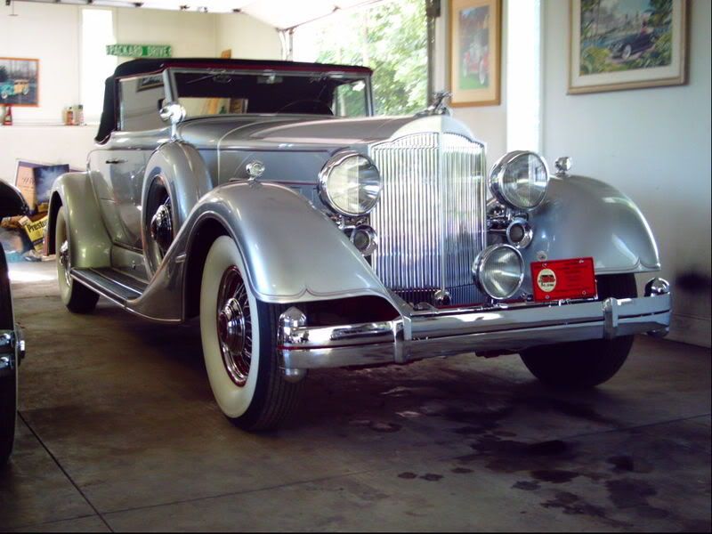

And now for a clean and even silver finish in BC/CC, and if you're willing to commit to the labor involved, this is a clean way to that end. Get the base on the car for coverage, paying some attention to the pattern but don't fret any minor changes. Walk away until the next day and be ready to surface the car completely. Sand all of it level to a minimum of 1000. Mix up the base again with 20-25% more solvent (maybe a slower solvent) and lower the pressure about 5psi, lower the volume just a bit, maybe a 1/4 turn at most, open the fan another 1/4 turn, test on paper to see an even pattern. Extend your spraying distance an extra 6-10" and apply the reduced base in broad and easy strokes. Go in an 'X' pattern, figure 8, whatever your comfort level is. You don't want a slick and shiney application, more like an even layer that doesn't leave rocks or the dreaded tiger stripes. Use a lot of light to see what you're doing. You should instantly see what this work nets and it becomes very easy to get a perfect pattern with no mini "bumps" in it, just smooth clean poly (micro flake in metallics). Go right to the clear coat and don't soak it, just take your time and trust the flow out of the product. At the end of it all, cut and polished it's magic. The light will play on body lines and features like no other. Yes indeed, it's a lot of work, pretty much like everything worth doing. The 2 pics posted are SS 'thane in deep maroon and BC/CC in ultra fine silver (correct for the era). Notice how the sun highlights the fender edges and such in the silver. You'll never regret doing good finish work on your own project. I'll be happy to offer tech support along the way if you like. Good luck...
This a car door and it's finish quality, the reflective values...
This silver applied like said above...
Same color indoors, different car...
