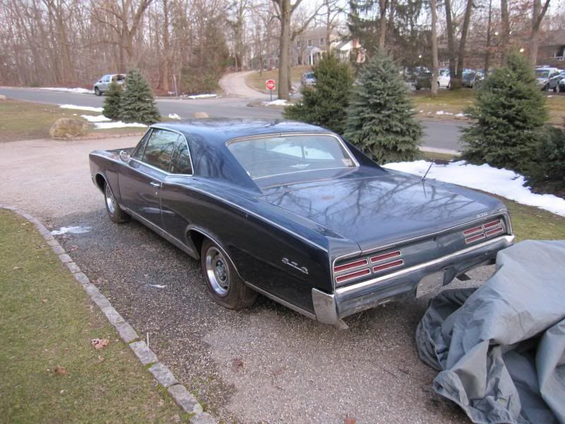

Here is what she looked like after we got her home and hosed of all the crud cobwebs and dirt.

Thank you! I'll post some pictures up tomorrow of the body. Then you will all see why she will be in the body shop by the Summer. The engine compartment is going to be some work too as the paint is peeling badly on the block and some one took a gold spray can to the brake booster and carb. It looks just plain ugly but 100% original and unmolested besides the unwanted spray paint.
