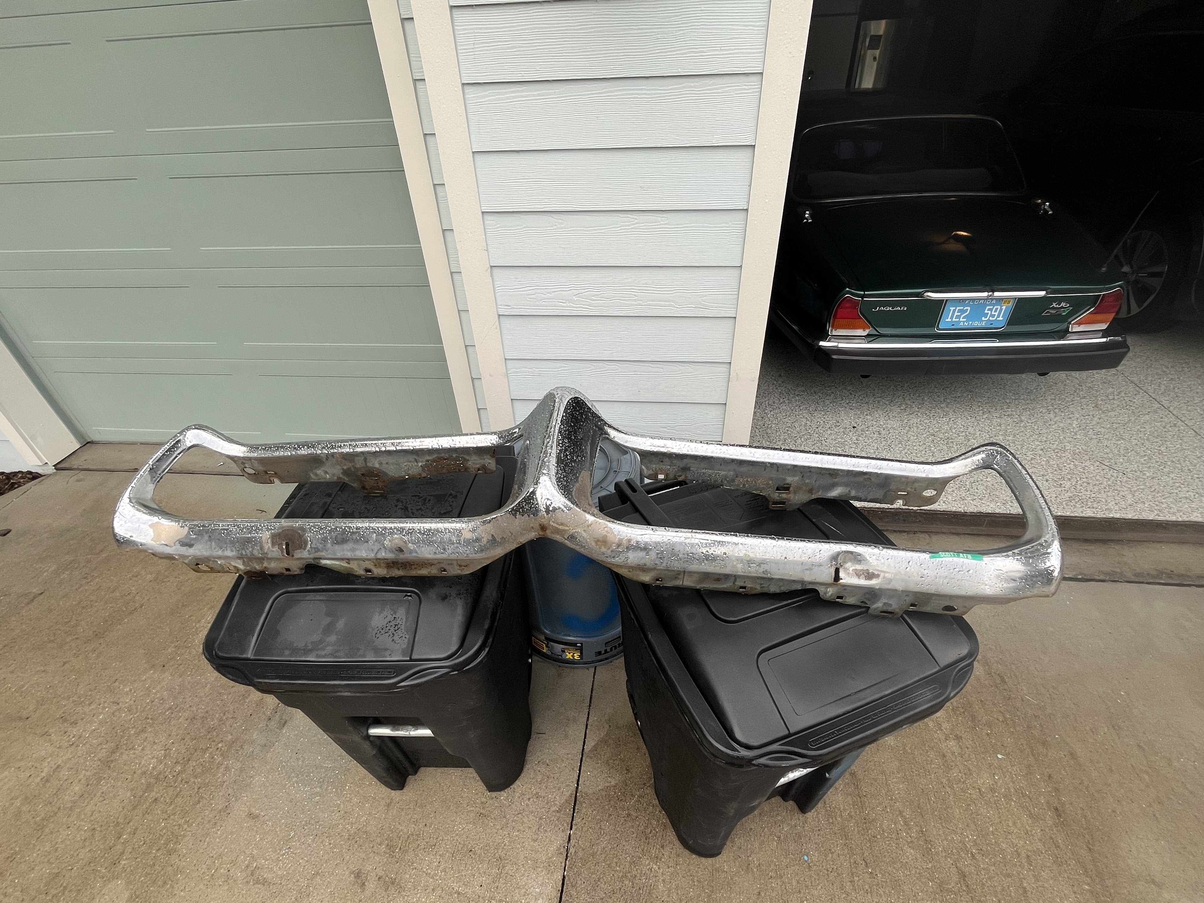

Okay being as I can’t seem
To find a better one, tomorrow I am contemplating taking my front bumper to a chrome shop, is this bumper salvageable? Or will be wasting my time? Chrome is peeling, there’s a lot of rust on backside but metal is solid! There are a few small dents also

The real question is...how far do the pits eat into the base metal. The chrome'r needs some meat to work with as they sand/grind the old layers off and if the pits are nearly through...they may cut through. A pit here or there and they can be welded up, but a pit-farm may just turn into a big weld hole. You have a rust pit farm there, best I can tell, but you'll have to judge how deep they go.
Call or email Kevin at Smitty's Chrome Shop (Nebraska). I'm trying him out on my front bumper and console pieces. Met him last weekend to drop off parts and he's good to deal with. I can't wait to see his results (and my bill...lol).

Here are photos of my front bumper so you can see what condition it was in. There is some pitting on the back side, but not bad, and a few small dent/gouges (circled below)...
This pit may need welded up?
Otherwise, a nice core.
