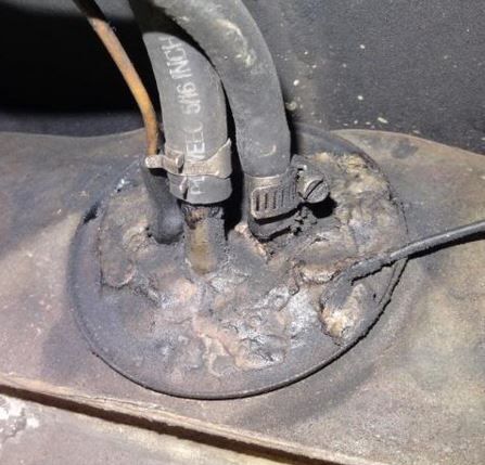

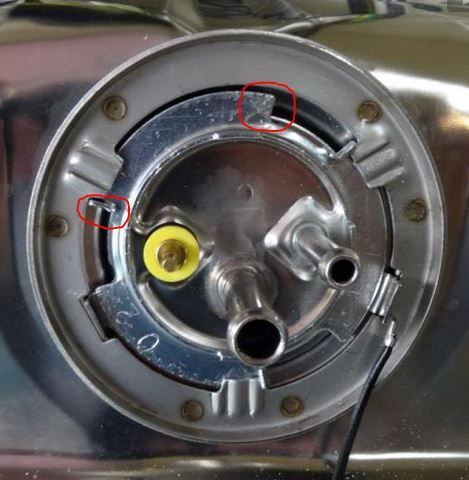

If you have a fuel pump with 2 lines, it generally means your car has a/c. The smaller second line runs back to your tank to help prevent vapor lock. You will only have one fuel line running from the pump to the carb. Here are photos of the sending unit at the tank, one before the new stainless tank was installed, and one with the new tank and sending unit. So to be clear, you do not need a filter with 2 outlets.

Thank you for the information but you did not quite answer my question. Yes my car does have factory a/c. Here is where I am confused. I have two fuel lines running into my fuel pump, I'm not talking about the fuel tank. Then from the fuel pump there is one line running into the carb.. Now this is a Elderbrock carb. not the factory Rochester. I am planning on putting a Rochester carb on the car. So from what I gather I will need the fuel filter, the one that sets on the intake manifold, which has the three spouts on it. One is for the fuel coming into it from the fuel pump then one goes to the carb and the big question is where does the third one go?? I know it is suppose to run back to the fuel tank but from the fuel filter where exactly does it connect?? Is this a rubber hose or a metal fuel line??
